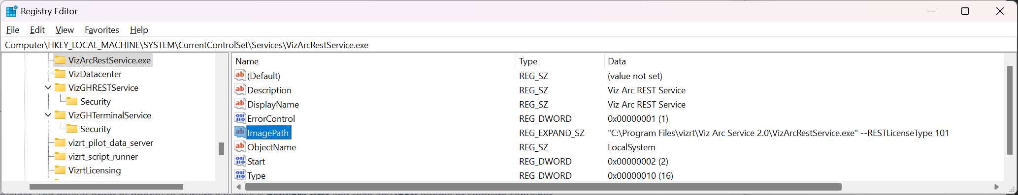

The switch can be added to the registry entry under Computer\HKEY_LOCAL_MACHINE\SYSTEM\CurrentControlSet\Services\VizArcRestService.exe:
The sample above forces the usage of a v3 license giving precedence to a network license over a local license.
